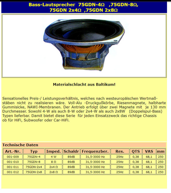

75ГДН-1-4 (30ГД-2)
Резиновый подвес динамика обычно не поддается разминке и вернуть низкий резонанс без замены подвеса не получается. Из подвеса испаряются пластификаторы, резина становится жесткой.

I had 2 copies of the 75GDN-1L-4, rubber, with resonances of 25 and 30 Hz upon purchase. After a long break, the resonances rose to 38 and 32 Hz, respectively. After warming up and cutting out the sectors from the centering washer, the frequencies dropped to 27.5 and 29.5 Hz, respectively. The first has a rigid centering washer, the second has a rigid suspension!
There is a scatter of parameters from the factory.

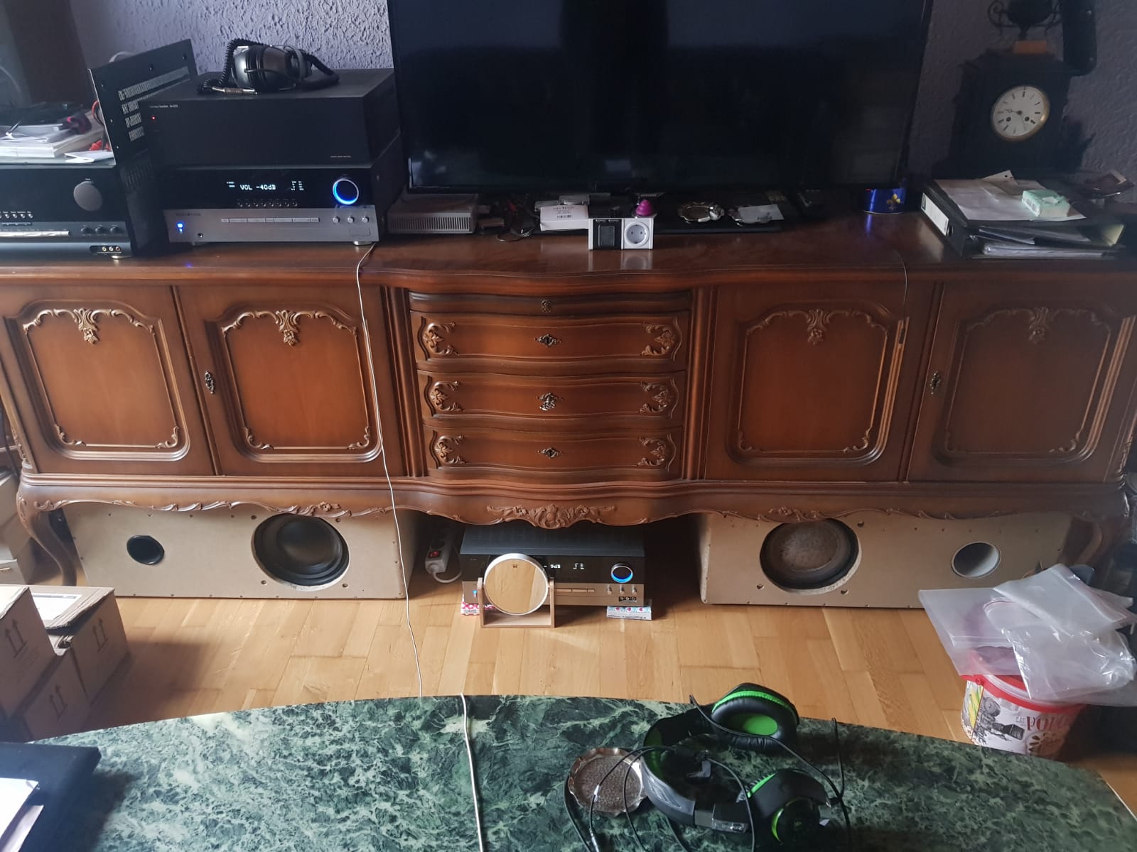

I'm going to build a test case with around 100l and try to make it sound reasonably good.

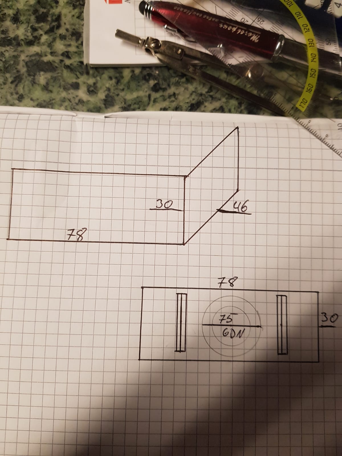

I'll just put in a pipe, no slots, and the speaker will move to the right more. it is not possible for me to vote for slots at the moment

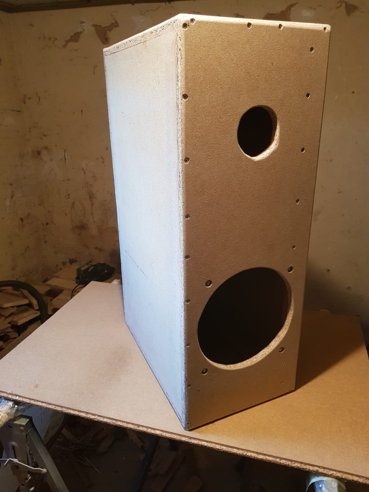

Hi
I have now made an 86l housing, unfortunately I have calculated myself ..
but I think that doesn't matter much or does it?

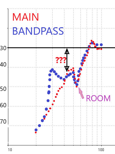

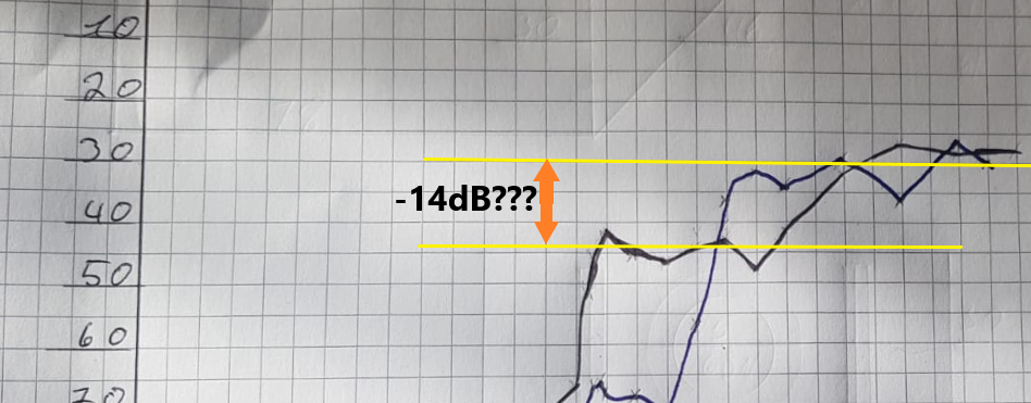

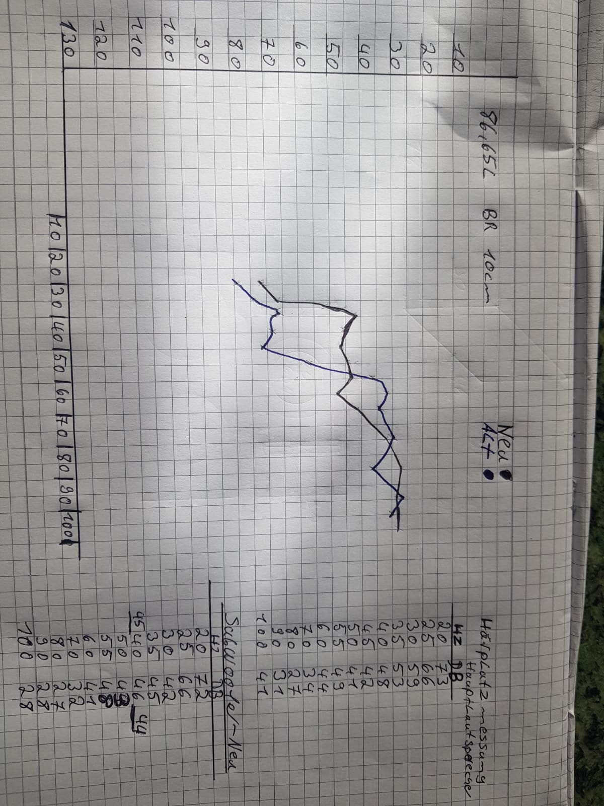

I measured an original and a new one at the listening position. the drawing shows the most important points, what does this say in comparison? black is the new reflex blue the old bandpass.

the table at the bottom right is from the new subwoofer
Above the tables are from the main speaker
the graphic contrasts the new with the original
I didn't write the table from the original on it, it's here in front of me
liebe grüße
да, верно, но, в конце концов, я не хочу сидеть на месте слушателя перед динамиком :)
If I understand correctly, you have problems either with the location of the systems in the room, or with the measurement process.
It is necessary to measure the characteristic near the new bass-reflex system in the middle between the port and the loudspeaker in order to understand what the system itself emits and what the room has contributed. So we will see if the bass reflex is set correctly.

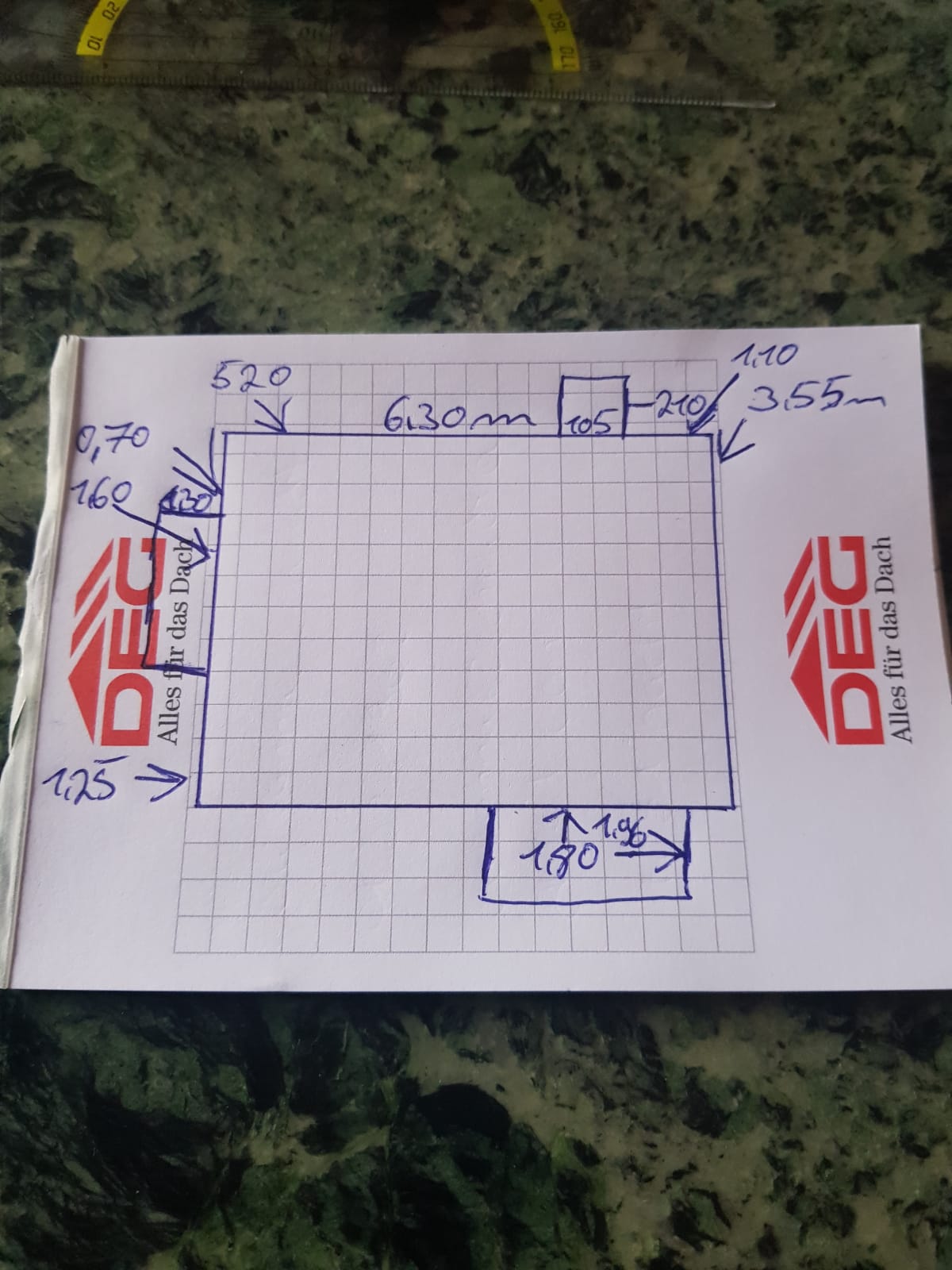

It would be nice if you could draw an accurate floor plan of the room with dimensions, distances, listening position and systems, and windows and doors. Perhaps the location of the listener is unfortunate.

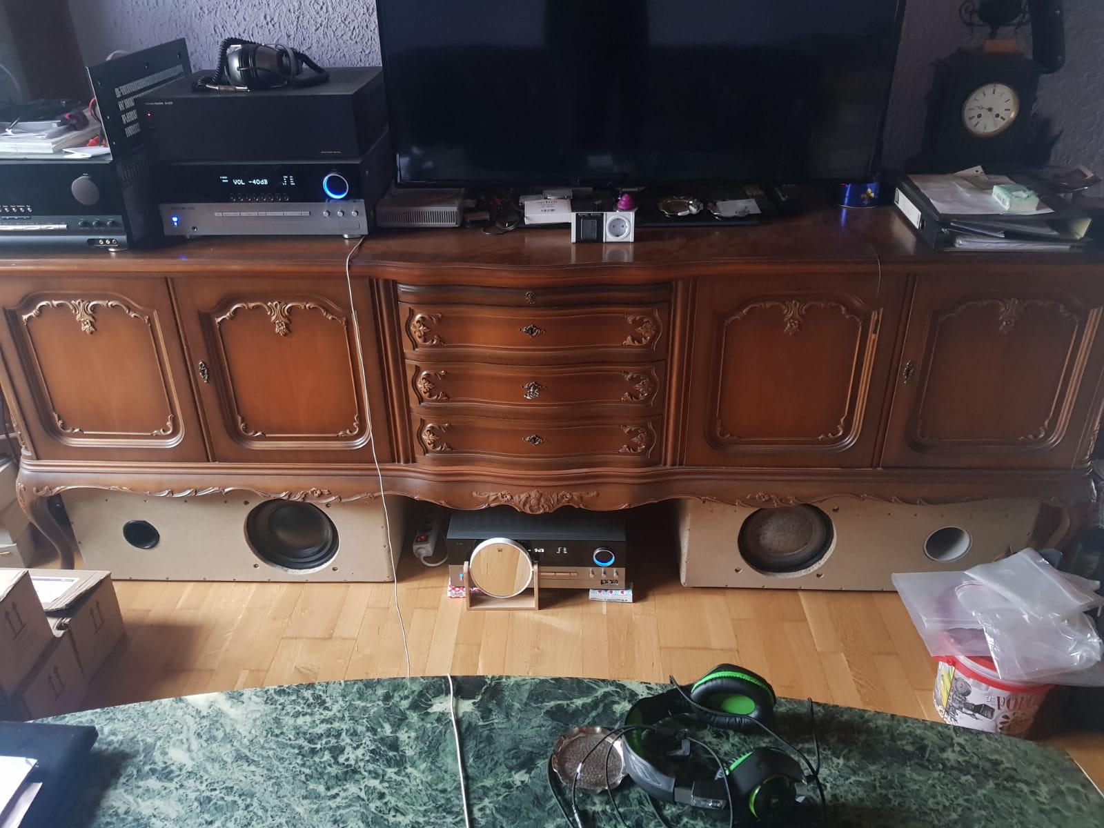

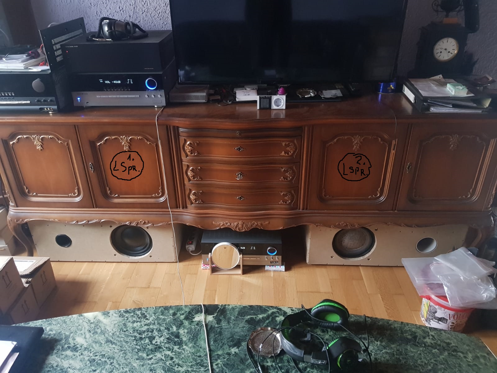

I'm building just the second case for the other side, then I'll perform a near field measurement.
I will change the BR Port, so up to + 10dB could get out of the woofer.
I'm curious :)
The room is a catastrophe! That's why I want to set up as many woofers as possible to regulate it digitally.

A sketch of the room I will make ready for clarification.

Draw your "indoor catastrophe". It may be enough to successfully position only two bass reflexes for good sound in the listening area.
If I do tomorrow, I almost finished the second.

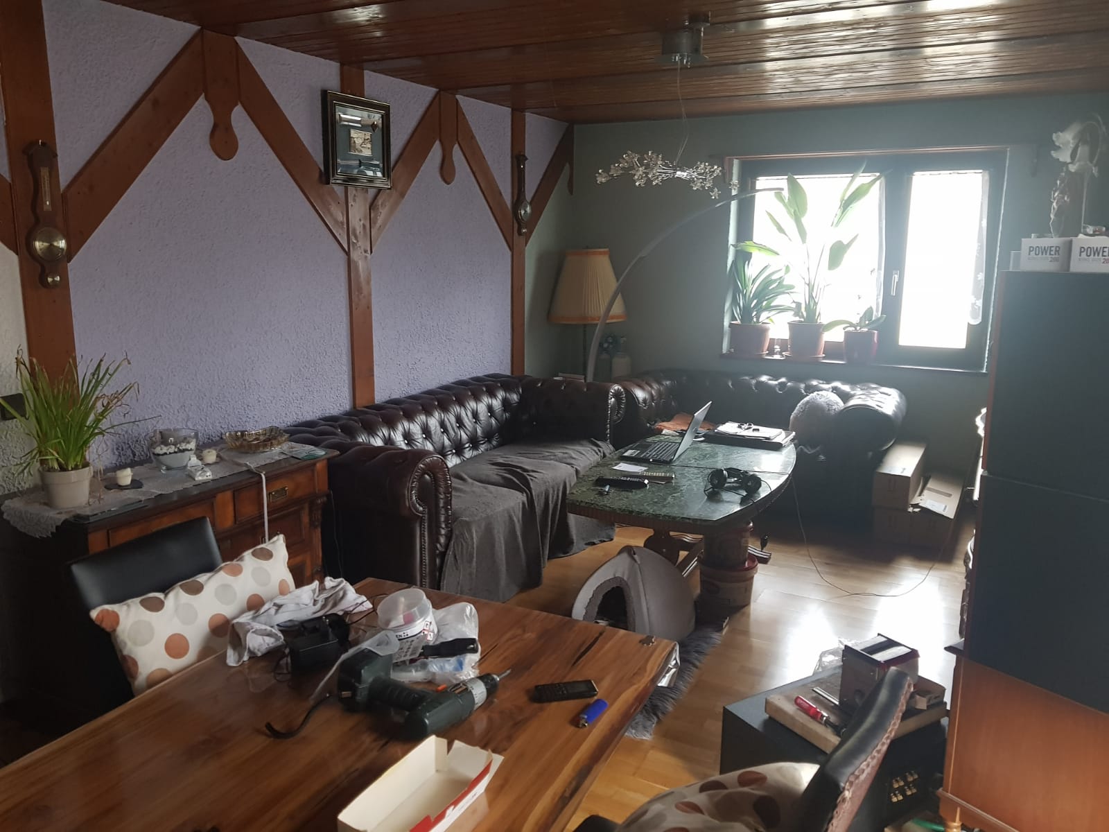

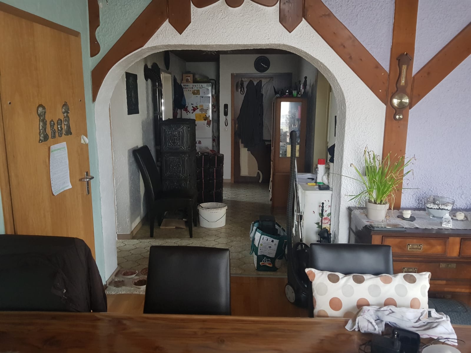

Unfortunately, I can not change anything, so a catastrophe is the whole thing :-)
I draw the dimensions and make some pictures then you understand what I mean.
I sit in a corner of a Ressonaz body
liebe grüße

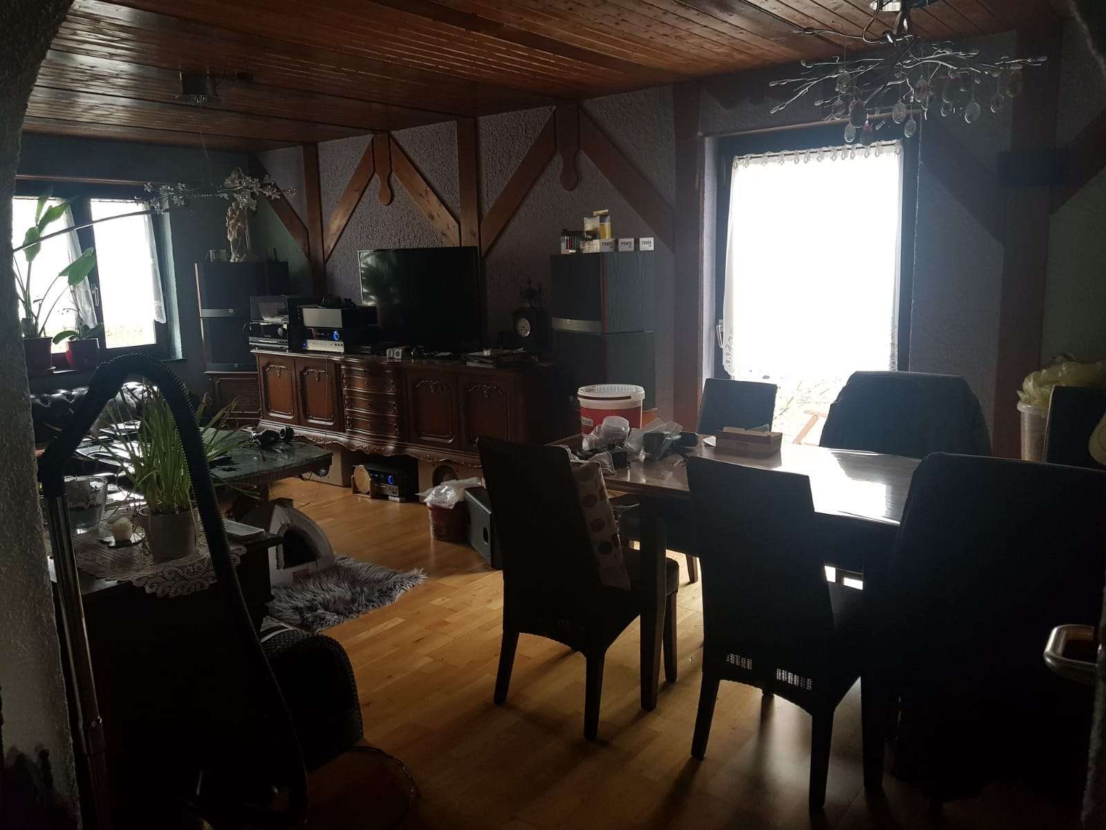

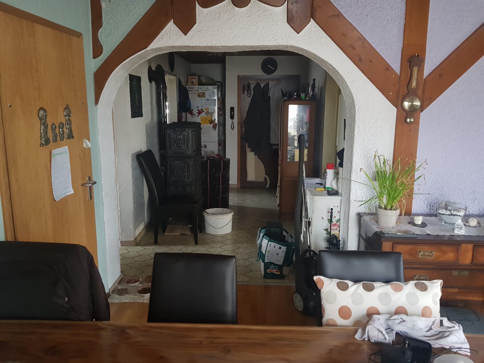

as you can see, there is not much that can be done .. i would have to tear out a wall and pull up a new one in a different place :)
Das is meine Vinil-Meloman-Katze
Und das ist meine Melomanchildkröte.

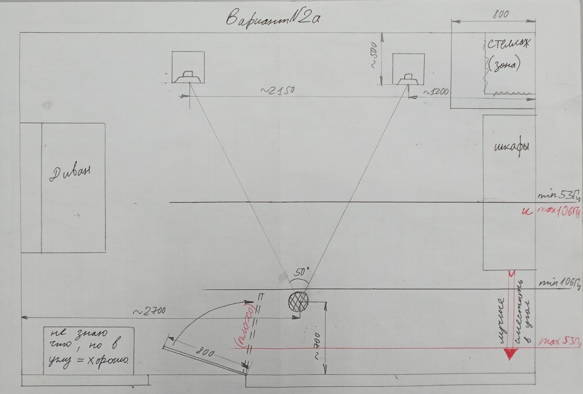

Regarding your case. The room is spacious, with no doors to the corridor, which is good for the sound. The main longitudinal resonance is 33 Hz, the main transverse resonance is 48 Hz. Not bad. If I understood correctly, the listener's position cannot be changed - he is sitting in the middle of the sofa. One main system stands in the very corner, the second near the window. The first has the worst position in terms of exciting room resonances. But if the lowest frequencies will be reproduced by new phase inverters, this is not too important. Since the main systems and bass reflexes are spaced apart, it is highly desirable to provide the same distance from the listener to the centers of the subwoofers of the main systems and from the listener to the centers of the bass reflex speakers. In this case, there will be no problems in fusion of the speakers in the phase of the sound pressure. You have something like that. Determine the height at which your ears will be, and specify the position of the two finished bass reflexes in the room. The lower the crossover frequency with the main systems, the greater the difference in distance to the listener is acceptable. Maximum permissible phase difference between signals at a crossover frequency of 60 °. For example, for a section frequency of 200 Hz, this is equal to 29 cm. Everything described above applies to a path without time delays in channels, with second-order Linkwitz-Riley filters (quality factor 0.5). At the crossover frequency, they give -6dB, +/- 90 ° phase shift and ideal total amplitude and phase characteristics. Therefore, the bass reflex speaker should be turned on in antiphase to the subwoofer in the main system. If you want to increase the number of phase inverters to four, then this condition must be met for all four phase inverters. Otherwise, it will be necessary to introduce time delays into the path or manipulate the filter Q-factor, which is more complicated and worse.
However, you have not drawn the position of the listener and bass reflexes in the room! Also report the height of the room and the height of your ears when listening.

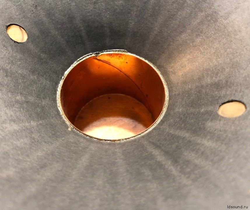

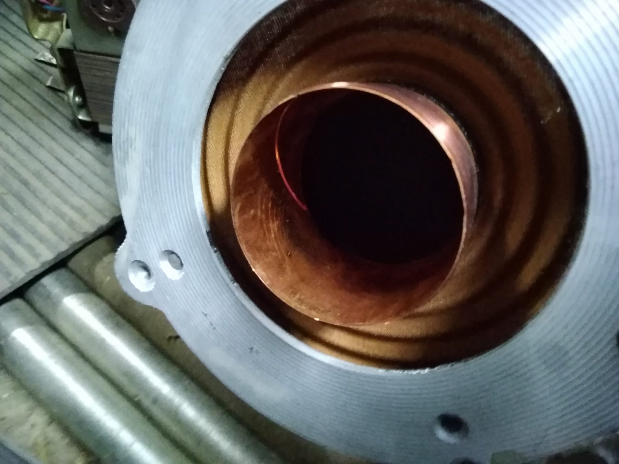

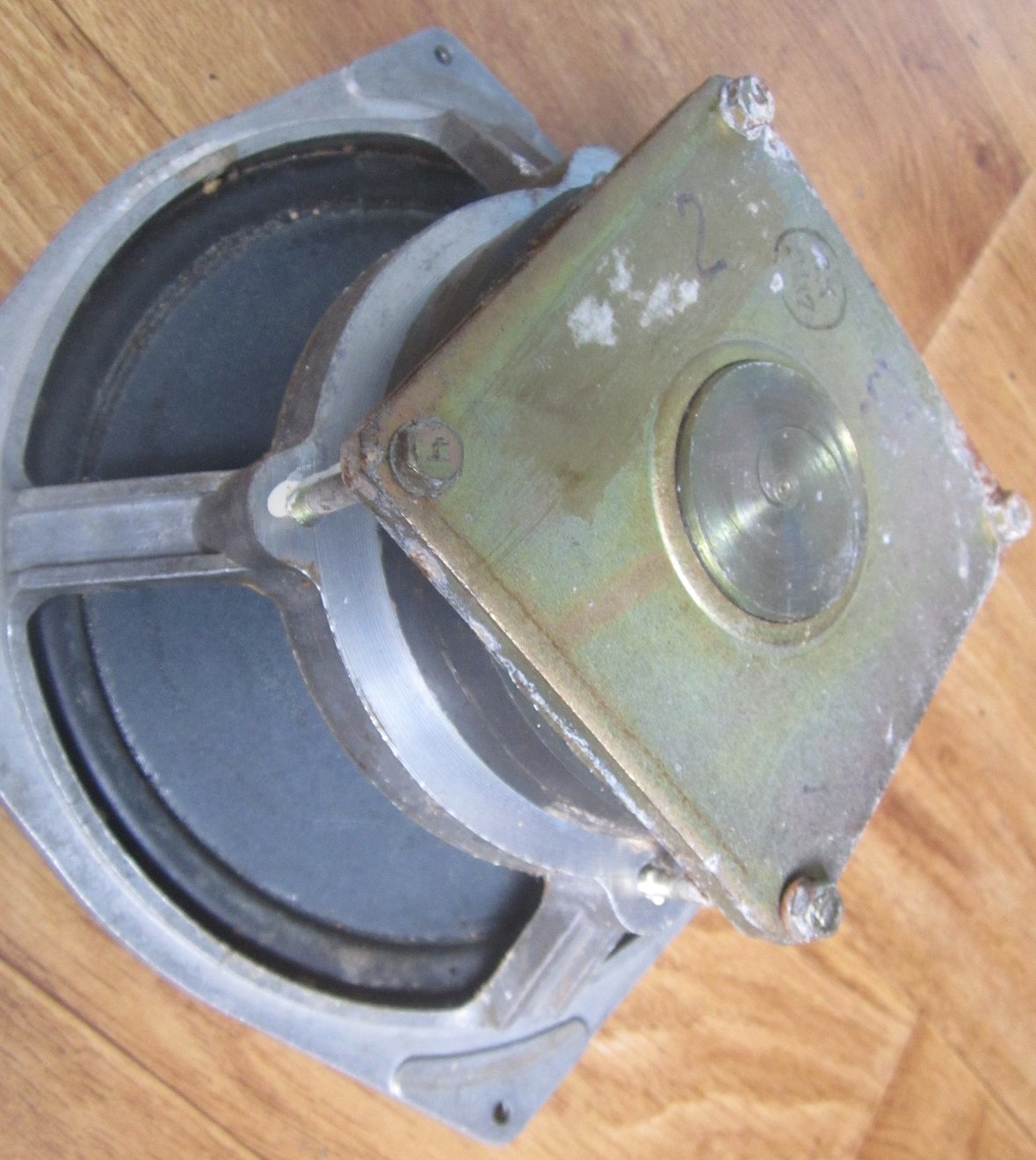

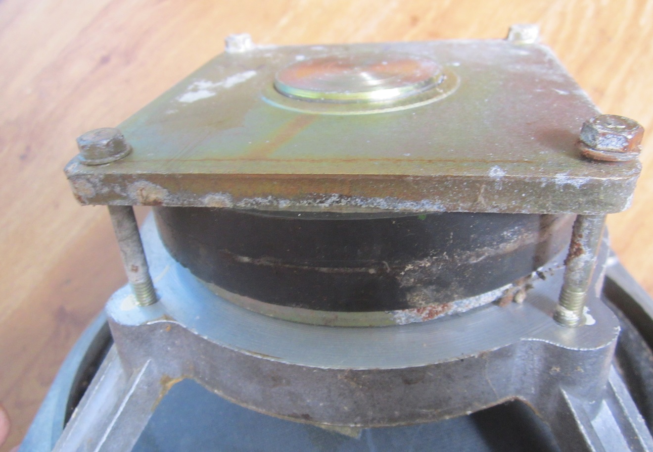

Скажите пожалуйста, катушка у 75 ГДН на каком каркасе намотана, медь или бумага?
Прислали фото 30ГД-1-25, там медь:
В то же время пишут, что у 75 ГДН так же медь:
Бумага на каркасе катушки только у прародителя. 8ГД-1-25 "RRR". У всех остальных его дочек и сыночков: 30 ГД-ХХ и 75 ГДН-ХХ каркас медный. Лишь в зависимости от применяемого провода для намотки катушки 0,315...0,355 по меди, менялось её Re. Высота намотки оставалась неизменной и равной 22,0 мм.
У 75ГДН-1 и 75ГДН-3 медь. Красивая, аж красная, советская)
Вы забыли про 25ГД-41, 25ГД-42, 50ГДН3-4, они как бы то же "детишки" 8гд-1-25, только каркасы катушек у них алюминиевые.
