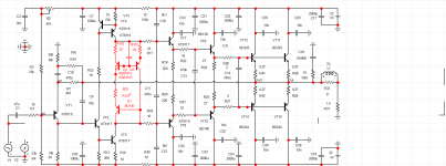

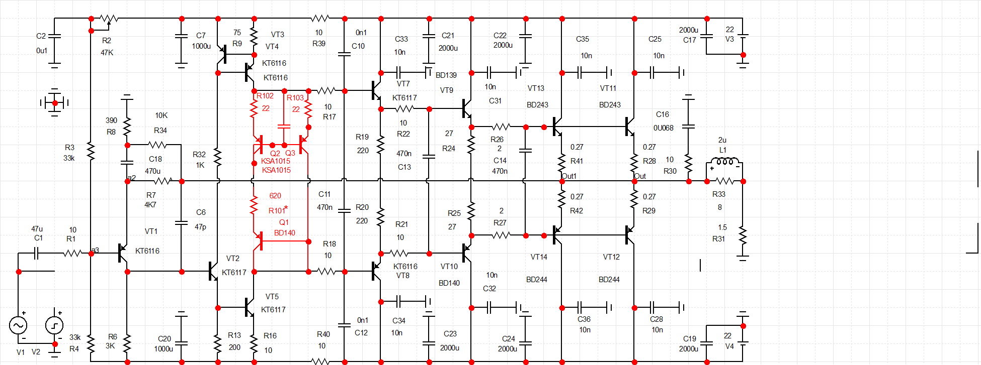

For me, you need to look at which un gives which spectrum. Of the simple ones, I like Melodiya's circuitry. Slightly changed. The only zero does not hold very well, but almost everyone suffers from this.
The original thermal stabilization circuit is highlighted in red. The sensor itself is two-wire, which means excellent noise immunity when twisting wires from it to the board.

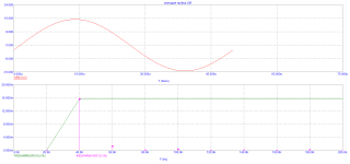

I think that you are in search for specific THD spectrum from power amplifiers and not for some 0.00000001% ultra low THD amp. , usually that `Single-End` THD spectrum consists from leading dominant second harmonic followed by lower level third harmonic , fourth, fifth and other higher harmonics need to be significantly suppressed up to -100dB or even more ,
amplifiers with opposite THD spectrum where leading dominant harmonic is third harmonic , followed by low level second harmonic is characteristic for quality Push-Pull amplifiers , here higher harmonics need to be significantly suppressed to , in both case those harmonics rise and fall in Monotonic way depending from input signal level ,
that sort of amplifiers is called or named `Euphonic amplifiers` , but not so much Hi-Fi , surprisingly usually those amps sound very good to human ears ,specially at long listening sessions , they do not burden human ears very much ,
here`s one example of such small simple `Euphonic` amp. which consists only from four transistor , THD % is not so good , almost mediocre , but THD spectrum is almost as is come from some Triode Single End tube amplifier .
Best Regards

I'm not looking for anything. I found this a long time ago.

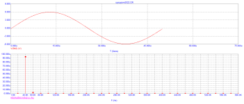

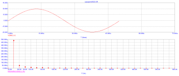

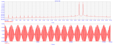

P.S. Spectra of 2 different amplifiers .Simple and complex

Что то похоже, что ни схемы ни железа. А тем более и обьективных результатов.

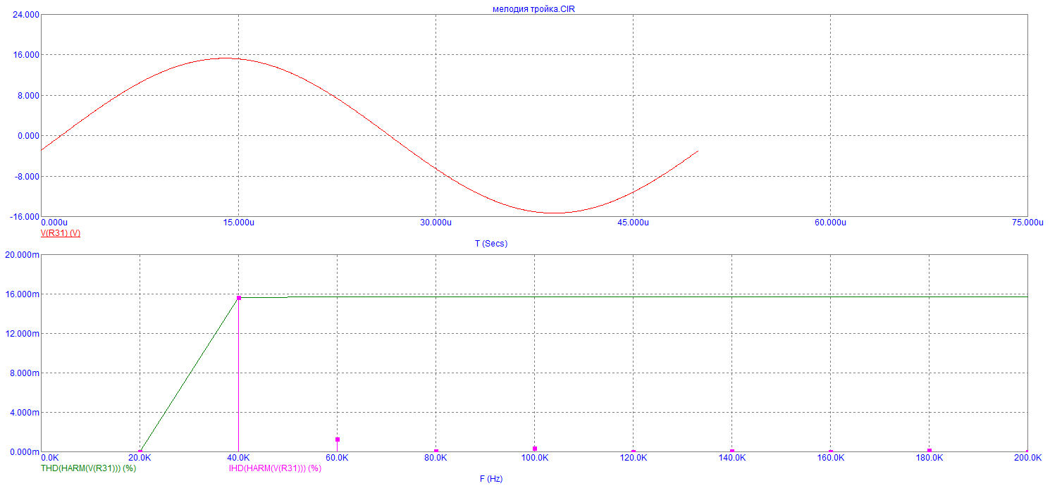

Усь по подобию Мелодии с тройкой неплохо смотрится. Ток покоя стабилизирует токовое зеркало. И не нужен конский ток покоя, всего 55ма на пару
Так у вас УН двухкаскадный, или я опять неправ?
Можно конечно и двухкаскадный, но мне интересны варианты однокаскадного УН с большим усилением

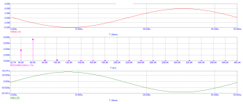

я же сказал про зуевик. клоны

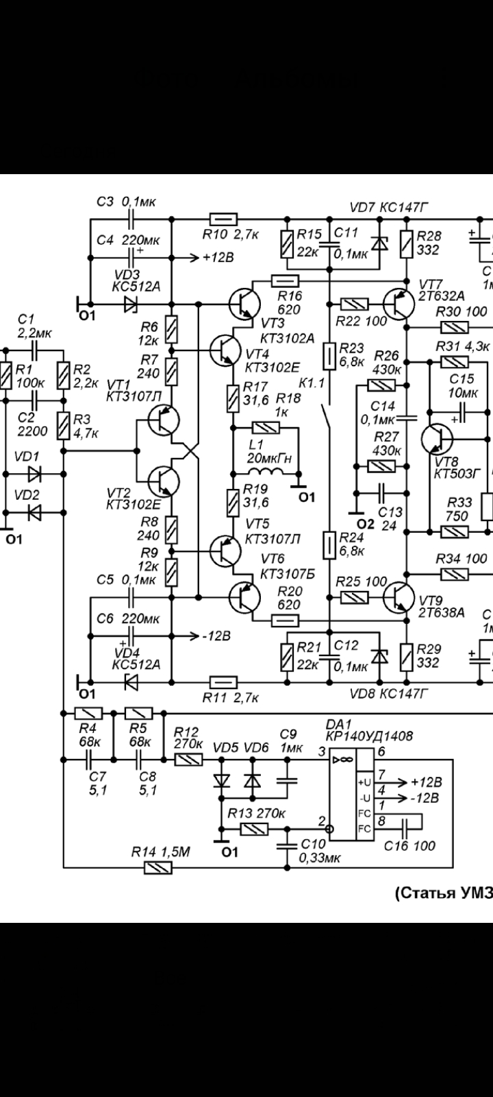

Можете сказать, здесь два каскада усиления по напряжению,два или один?
Я вижу два, М. Васильев говорит что один...Screenshot_2022-08-30-11-39-09-434_com.miui.gallery.jpg
Т3, Т4 разве не усиливают по напряжению?
Я вижу два, М. Васильев говорит что один...Посмотреть вложение 52062
Симметричный каскод на входе в роли повторителя тока и ОБ на выходе. Усилитель напряжения один, на выходе.
Один . Т3 и Т6 элементарный каскад сдвига уровня. И каскод ОЭ_ОБ
